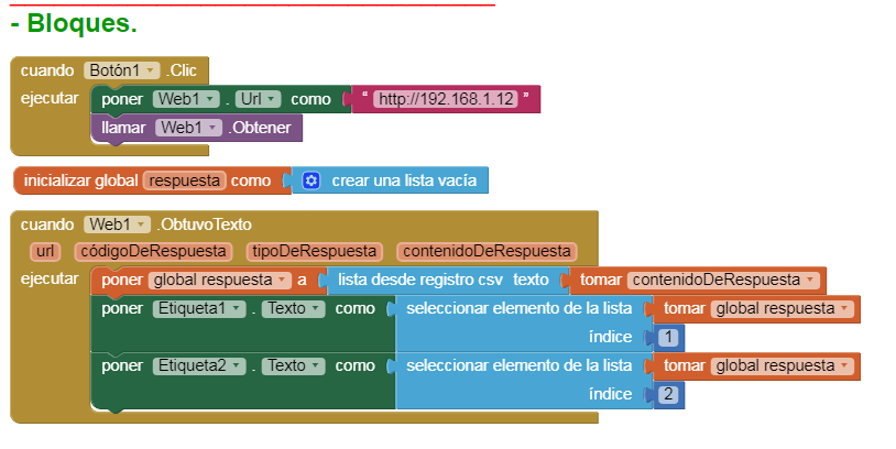

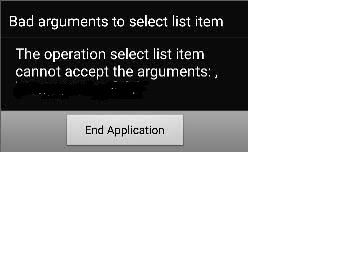

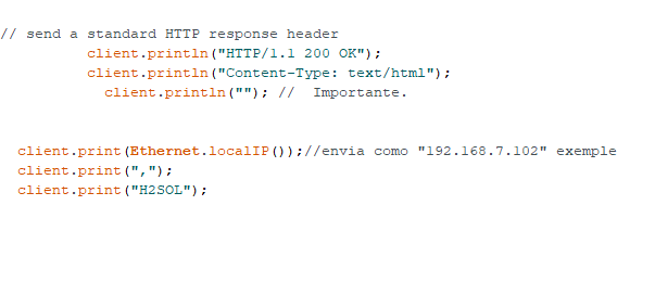

I tried to use your exemple :148.- Wemos D1 R32 ESP32. Obtiene humedad y temperatura por WiFi y lo presenta en LCD. to receive from arduino 2 informations: the device IP address and one string but I receive the following mesage:
Bad arguments to select list item .The operation select list item cannot accept the arguments.
I have been attached part of my scketch and app inventor blocks.
Could you please give me any idea how to solve the problem.
error message.png (22.17 KiB) Visto 117834 veces
